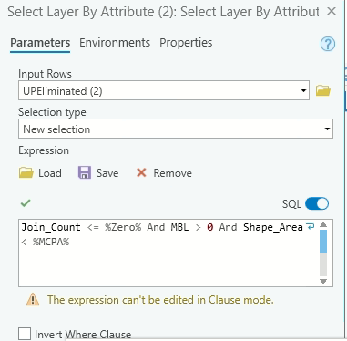

I've created a model using ArcGIS Pro 2.5.1 that works fine when I write all outputs to the file geodatabase. So I want to improve performance and write intermediate outputs to in_memory Workspace. I was surprized to find that just changing the location of outputs that are not parameters can cause the issues.
For example Select by Attribute tool stops with a message "Invalid expression". After changing back to .gdb location it works fine. Here is the expression.

@ROMANFILOZOF ,
You are getting the message "Invalid expression" because the Shape_Area field is most probably not available in your shapefiles' fields by default. But when you import your shapefiles into a gdb, some fields are automatically created/calculated by the gdb. These fields are Shape_Area, Shape_Length, ... and FID becomes OBJECTID.
I hope that helps.
Mehdi

ROMANFILOZOF
Thanks! That explains the expression error!
