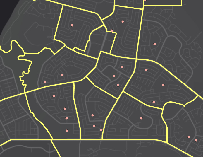

I'm not sure if I'm misusing this tool, but when I run it I'm getting an outcome which seems contrary to my understanding of the tool.
Basically, I'm trying to summarise a point layer within a polygon layer. See screenshot below:
I would expect the result to be polygons with the summarised data of each point, contained within each polygon.

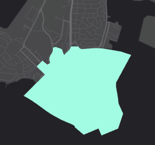

Instead, the summarise within tool is only returning one polygon:

Is there by chance that you have a multipart polygon?
Open the table for your polygon layer... are there individual records for all those visible polygons? or is there only one record? (ie it is multipart.
The only other way you could have 1 polygon as output is if you havea selected polygon.

If you overlaid the points onto the polygon layer, what other options did you choose? and can you confirm that there is only one record in the table of the resultant output polygon layer?

Here's the resultant data:
So you also think I should be getting more than one polygon?

You could be onto something with the second part, because the process is working as intended now. Maybe I had selected a polygon without realising... Not sure.
