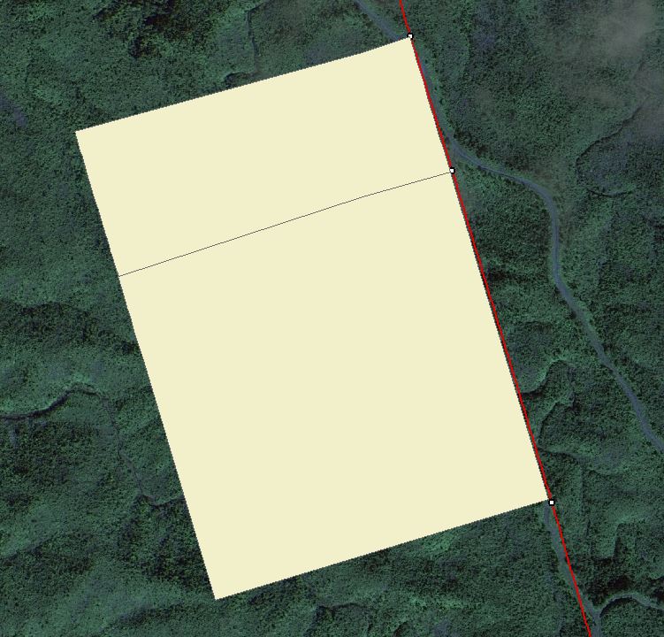

Does anyone know if there is a way to split a polygon layer (in this case it is a buffer around a line) into multiple polygons by a specified distance? I am trying to create multiple polygons out of the buffer that are each 10m wide along the line segment. The buffers look like this:

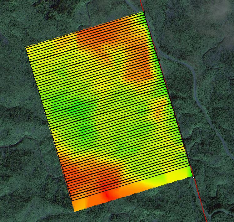

And what I want is for the buffer to turn in to this where the black rectangles are the new polygons split by 10m intervals (this layer I manually created, quickly):
