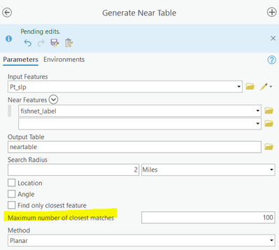

Generate Near Table should work for you.
Uncheck "Find only closest feature" in order to specify a limit to "Maximum number of closest matches".

@JayantaPoddar ... True... but that will result in that ridiculously sized table I was referring to,

You could be right. I have just laid out the feasibility of the process, rather than focusing on the size of the output table. I have left that decision at the discretion of the user.

THANK YOU! Thank you so much - I tried it this morning, this seems to be just what I needed. I mean, yes - the table is enormous, but it we can work with that.
NonieCastro1
Thank you again! I tried another, larger list of points, and just to be 100% certain, double checked the resulting table against the map - worked like a charm! What a relief, I was so stumped. You've been an enormous help.
