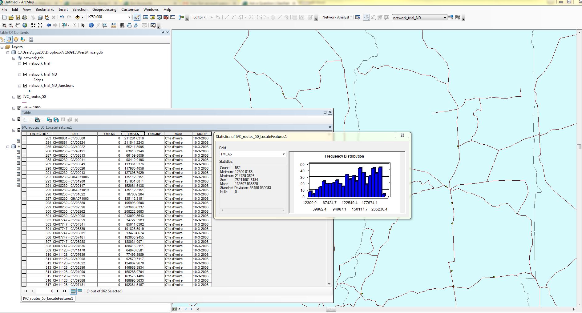

To illustrate the problem, some screenshot are pasted below:
"Locate feature along routes" tool works well for shorter routes. It can be observed that the maximum route length never exceeds 215 km after several tries.

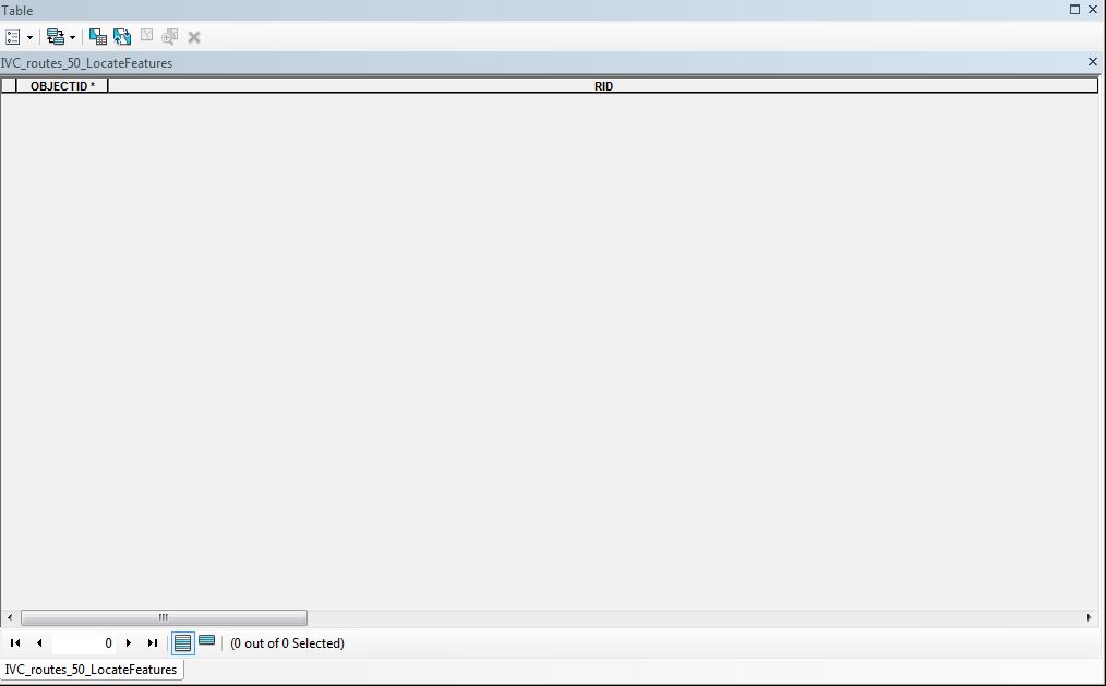

If one long route is chosen:
No result will be produced in the output event table.
