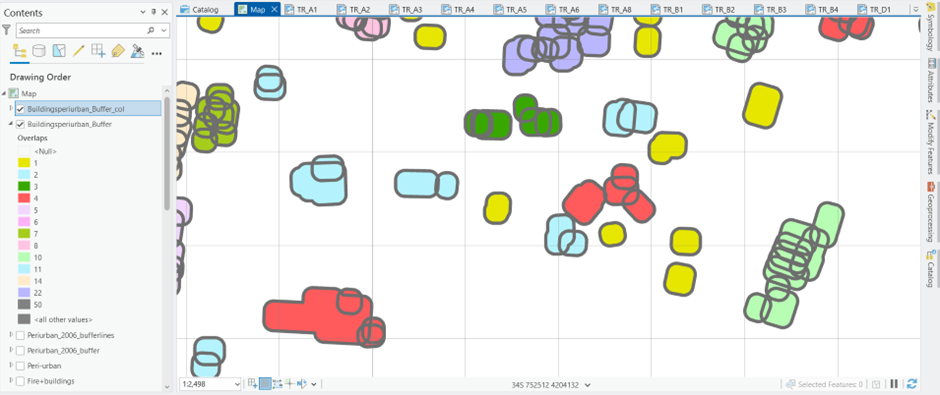

Hello. I’m following up from a recent post regarding the quantification of polygons (features) that overlap. As I currently understand it, the Count Overlapping Features (COF) tool is a misnomer since the result enumerates the number of overlaps rather than the number of features which overlap. So currently, using COF, 5 different overlapping polygons could produce a count of 3, whereas I am interested in how many polygons overlap to create a distinct cluster (5 in this example). To clarify: I would like to quantify the number of polygons (buffer areas surrounding buildings in this specific case) which intersect with each other rather than count the number of times different polygons happen to overlap. I have attached a screenshot of the output I wish to achieve (produced by manually selecting and changing the attribute of each polygon that overlaps to form a distinct cluster). Is there some automated method which could provide me with desired results?

This may not be the cleanest way to do it but it's automated and seems to work:
  1. Buffer polygons
  2. Spatial Join
    • Target features: buffered polygons
    • Join features: buffered polygons
    • Join operation: one to one
    • Match: Intersect
  3. Symbolize output by the Join_Count field
    • You'll need to subtract 1 from the Join_Count field to get the number of times a single polygon overlaps another polygon (field calculator would work well for this)test2.png

CristoforosRomanos
Hi Jon. You must be a magician. Your proposed method works. Perhaps not perfectly (especially at the highest end of overlaps where some visual sorting is required) but it is extremely helpful and certainly cuts down on the time I need to dedicate to this task. My sincerest thanks.

Have you explored the Polygon Neighbours tool, sounds like that tool could do what you want?
CristoforosRomanos
Thank you for the tip Duncan. I am looking for a way to analyze the overlap of a "chain" of multiple polygons forming larger clusters. After testing the tool you suggest, I found its analytical capability is limited to the immediately adjacent polygons. The output is quite similar to the Count Overlapping Polygons which hasn't helped me. I do not think the software currently has a tool for the required task.
