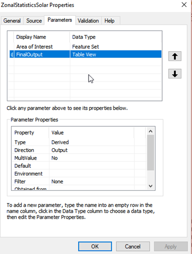

Hi, I am tryng to publish a relatively simple python script as a geoprocessing service. The tool works well when executed locally.  It also publishes correctly, but I get the following error when the geoprocessing service executes:
I would like someone to help identify what errors I may have my code, which is attached to this message.
Also, here are the parameters of my script-
Thanks.

I have enabled the info from the geoprocessing tool  and used the Scratch GDB for the final output.
After republishing the tool and trying to run it, I realise that my problem is on  setting  environment workspace.
The current work space is ,\\xxx\arcgisserver\directories\arcgissystem\arcgisinput\test\ZonalStatisticsSolarDataAccessTestSec.GPServer\extracted\v101
The considered work spaces GDBs are ,[]
I expected to get the environment I set as \\xxx\Server Objects\Data\Raster\Solar
and then the GDBs inside this workspace
The errors are related to the tool messages on line 20 and line 28 on the attached updated script

Any idea how I can handle workspace settings.
