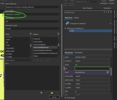

EricBregant2
So my data is not from Portal so I assume I would use FeatureSetbyName()
Below is what I am working with:
My Zip code layer is named  GISMAIN.DBO.qc_ZipCodes
The field I need to grab data from is "GEOID10"
My dataset that needs the Zip Code appended in is called Addressses_TestData
I basically need to make the user be able to click to add the address point, and have it populate the Zip field with the data from the layer under it.
