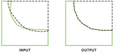

Hi @JMik ,
I reckon Integrate is the tool you can use to align two boundaries.
Make sure to make a copy of your original feature class as this tool does changes on your original feature class (in ArcGIS Pro, you have the option to enable the Undo mode) and you also need to find the right xy tolerance based on your dataset.
ArcMap:
https://desktop.arcgis.com/en/arcmap/10.3/tools/data-management-toolbox/integrate.htm
ArcGIS Pro:
https://pro.arcgis.com/en/pro-app/latest/tool-reference/data-management/integrate.htm
I hope that's helpful.
