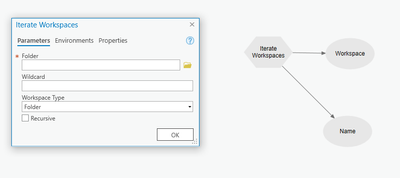

@JohnnyJohansson , I don't believe this can be done in Model Builder, as you need the arcpy.mapping functions to manipulate and group layers inside an MXD.
Theoretically, you can add the "Iterate Workspaces" module, and set it to work non-recursively on your parent folder.
Then you could iterate through the layers and merge them into one dataset, but then you'd have other challenges that I'm guessing you don't want to deal with. And would rather you just had a merge layer file containing the layers from you old 11 layer files?
If so, Python is your ticket out of this one.
David
..Maps with no limits..
