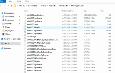

I'm comparatively new to ArcGIS and am trying to automate Geocoding. Since there is protected health information, I am performing this in ArcGIS pro with Jupyter notebook (though I'm having this issue both with and without using the Python script) and a locator. I have not had this issue in the past: only the data has changed (still a csv file). (I've always had to go into the ArcGIS "MyProject" folder to find the .gbd table (not sure if there is another way of doing this, retrieving the individual .gbd table vs a feature layer--or another file that I can actually name is kind of a pain).

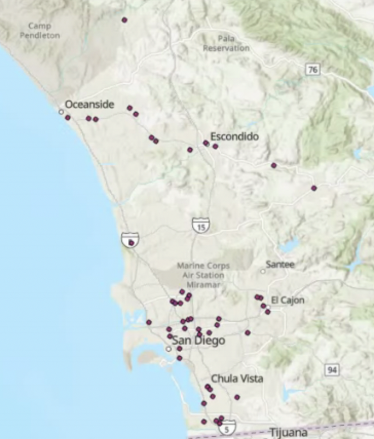

You can see from the map that there are addresses geocoded.
However, when I look through the ArcGIS project folder and find the appropriate .gbd table. It just shows this
Here is the script and also a screenshot of the fields I've completed in the Arc pro interface.

@Jades1 you will not be able to identify individual featureclasses when viewing a geodatabase in file explorer, just the mess of files you shared in your screenshot. To see individual featureclasses you have to use ArcGIS Pro's Catalog pane. You can use arcpy.ListFeatureClasses, but make sure to first set the arcpy.env.workspace environment variable to the path of your geodatabase to list all the featureclasses within it. Regarding converting the featureclass to a spatially enabled dataframe (SEDF), see from_featureclass in arcgis.features module | ArcGIS API for Python.

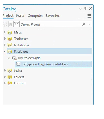

@Jades1 Is the output feature class named "cyf_geocoding_GeocodeAddress" not listed in the Contents pane in ArcGIS Pro? You should be able to view the "MyProject1.gdb" file geodatabase in your project in Catalog pane underneath Databases or in the MyProject1 folder under the Folders item.
Jades1
Hi Shana,
Thanks! This is what I see:
When I look under my project in Arc this is what the output of files looks like:
ShanaBritt
@Jades1 , The Project folder in your case is named "MyProject1" and within the project is the default file geodatabase which has the same name as the project "MyProject1.gdb". The file geodatabase (.gdb) shows up in Windows Explorer or File Explorer as a file folder and  you won't find the feature class name listed in the geodatabase folder there. In the Catalog pane if you expand Folders item, you will see "MyProject1" as the folder and the "MyProject1.gdb" listed as well. Below are some resources for more details about file geodatabases:
https://pro.arcgis.com/en/pro-app/latest/help/data/geodatabases/overview/types-of-geodatabases.htm#G...
https://pro.arcgis.com/en/pro-app/latest/help/data/geodatabases/overview/what-is-a-geodatabase-.htm
https://pro.arcgis.com/en/pro-app/latest/help/data/geodatabases/overview/fundamentals-of-the-geodata...
What is it that you are trying to do with the "cyf_geocoding_GeocodeAddress" feature class in the "MyProject1.gdb" file geodatabase?
