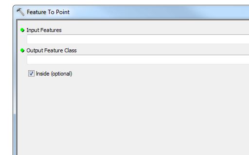

One trick that has worked for me (in ArcGIS Desktop) is to create pseudo-centroids (points, within) from one of the layers (probably the PUMAs) and then perform an identity study to get back points with attributes from PUMAs.  You can then join that result to the original (polygon, PUMA) layer to give them the attributes (such as metro area IDs.  I call them pseudo-centroids because a horeshoe-shaped polygon will have its centroid located outside the polygon.  To address that the ArcToolbox "Feature to Point" tool has an "inside" option that if necessary, arbitrarily keeps the resulting point inside the polygons.  This works, if in the aggregate the layers' boundaries match.
The ArcToolbox tools are
"Feature to Point" under ../Data Management Tools/Features, and
"Identity" under "Analysis Tools/Overlay/"

DanShaffer
Deactivated User
That worked thanks!!
