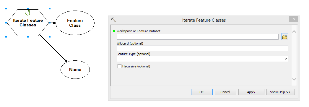

You ask a question about the Feature Class iterator then make a reference about your map document, which makes no sense. The Feature Class iterator takes as input a Workspace such as a folder or geodatabase and has nothing to do with map documents. If you are using the Feature Class iterator then the only way to subset what it spits out is by setting the wildcard and feature type parameters.
FeatureClass Iterator
You may be trying to employ a workflow that cannot be easily supported in model builder and best done in python?
