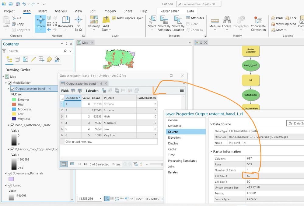

How can the cell size value be inserted into a specific field in the attribute table of a raster, as shown in the screenshot below?
