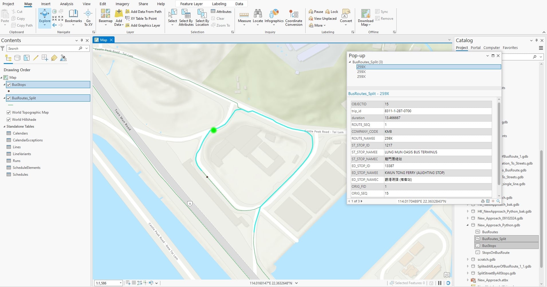

I am currently working on processing GTFS (General Transit Feed Specification) stop_times.txt data using ArcPy in ArcGIS Pro to create bus routes and stops, as well as to add durations based on each bus route. However, I'm encountering issues where the split lines are not being correctly split at the stop points. Specifically, some bus routes are not being split as intended, resulting in inaccurate segmentation of the routes. Can anyone give me a hand with this, thank you a lot.

Despite following the workflow, I observe that:
Incorrect Splits: Some bus routes are not being split correctly at the stop points.
Manual Processing: Performing the same operations manually in ArcGIS Pro's SplitLineAtPoint tool results in the same issues.

Thank you for your guidance on adjusting the cluster tolerance settings and your help. However, after removing the cluster tolerance as recommended, I'm still encountering the problem that the bus routes are not being split correctly at the stop points.
DanPatterson
MVP Esteemed Contributor
It would be useful if you showed the location of the bus stops to the route after Integrate, perhaps the tolerance isn't any good and web mercator coordinate system wouldn't help matters for things involving distance.  So in short, what is the actual distance relaytive to the lines and have you considered using data in a differenc coordinate system?
