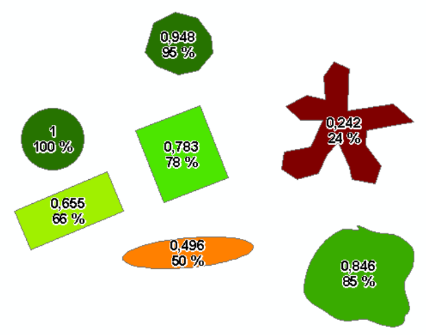

An example of what you get when  you execute this field calculation using the Python parser:
4 * math.pi * !SHAPE_Area!  / !SHAPE_Length!**2
