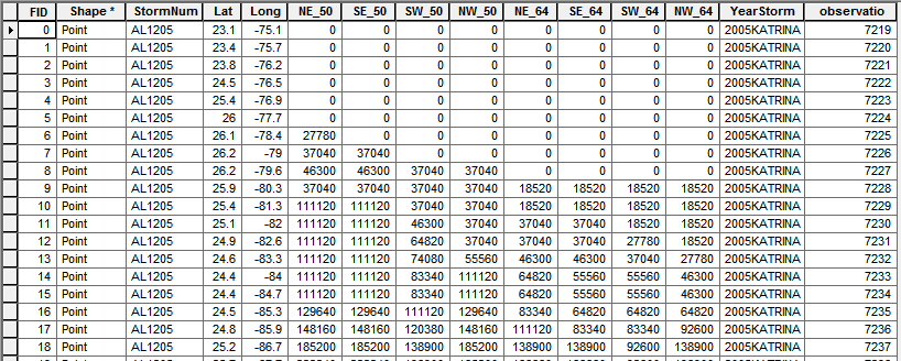

I am using ArcMap 10.2.2 and I have "extended best track" data for tropical cyclones which has latitude and longitude locations of storms at 6 hour intervals as well as estimated wind radii for the NE, SE, SW, and NW quadrants at those locations. For instance, at lat x long y, this data might have estimated radius for a 64 kt wind of 100 nautical miles in the NE quadrant, 75 nm to the SE, etc.
So basically, I want to buffer these point locations with quadrant specific radii based on the attribute for that quadrant. Is this possible to do? I'm not well versed in coding but I would be willing to try to figure it out if it is possible and can be automated either with python or model builder to do for multiple storms. Any suggestions would be much appreciated.

... with arcpy.da.SearchCursor("HurdatProductARCMAP",["SHAPE@","NeMtr","SEMtr","SWMtr","NWMtr"],spatial_reference=sr) as cursor : # loop through points
...     for row in cursor :
...         cur=row[0].centroid # convert point geometry to point object
...         up = arcpy.Point(cur.X,cur.Y+max) # make points from which to make boxes later
...         upright = arcpy.Point(cur.X+max,Cur.Y+max)
...         right = arcpy.Point(cur.X+max,cur.Y)
...         downright = arcpy.Point(cur.X+max,cur.Y-max)
...         down = arcpy.Point(cur.X,cur.Y-max)
...         downleft = arcpy.Point(cur.X-max,cur.Y-max)
...         left = arcpy.Point(cur.X-max,cur.Y)
...         upleft = arcpy.Point(cur.X-max,cur.Y+max)
...         boxes = {"NE":arcpy.Polygon(arcpy.Array([[cur,up,upright,right]]),sr),
...                 "SE":arcpy.Polygon(arcpy.Array([[cur,right,downright,down]]),sr),
...                 "SW":arcpy.Polygon(arcpy.Array([[cur,down,downleft,left]]),sr),
...                 "NW":arcpy.Polygon(arcpy.Array([[cur,left,upleft,up]]),sr)} # make boxes
...         for field in cursor.fields[1:]:# loop throught the fields following the point geometry field
...             cur_buff = row [0].buffer(row[cursor.fields.index(field)] # make a buffer
...             clip_buff = boxes[field[:2]].intersect(cur_buff,4) # clip the buffer by the corresponding box
...             out_buff.append(clip_buff) # record the wedge
...     arcpy.CopyFeatures_management(out_buffs,r'in_memory\out_buffs') # write the wedges
Parsing error SyntaxError: invalid syntax (line 22)
Hello, I have been trying the code provide but I receive an invalid syntax at line 22 and I don't know what can be. Can anyone take a look?
Thank you
DanPatterson_Retired
MVP Emeritus
out_buffs, maybe out_buff
