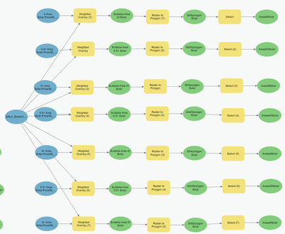

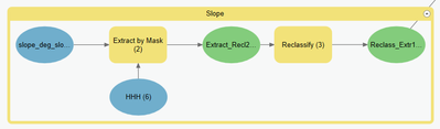

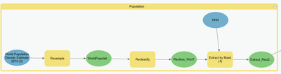

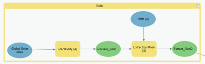

This is what 1 model looks like.
I want to do a suitability analysis on the best places to place  hydrogen system in three scenarios, Solar / wind / Solar&wind, based on certain criteria; Solar irradiation, windspeeds mean, population density and slope. These criteria all have classifications ranging from 1-6 , meaning 1 is bad and 6 is really good. So for example, mean windspeeds from 1-3 m/s are category 1 and 11-15 m/s are category 6.

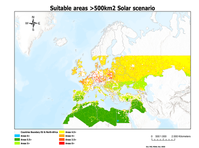

The desired output is a heatmap per scenario which shows areas above 500km2 with the best and worst combinations of the criteria, ranging from red(low score) to dark green (high score).
The inputs are:
CharlieGroenewegen_1-1616068823013.pngCharlieGroenewegen_2-1616068836554.pngCharlieGroenewegen_3-1616068852817.png
The first one is solar data which is reclassified and then extracted for certain countries.
The second one is population denisty which is resampled, reclassified and extracted for the same countries as for the solar data.
The third one is the slope data for those same countries as for the others data sets.

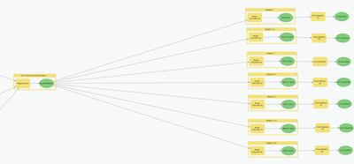

These are all put together into a weighted sum and then a raster calculator has been performed to generate certain classes on the weight scale eg., 1-2 & 2-3 & 3-4 etc.
After that the data is crossed with a "restricted area" map and the polygons gotten from the final maps are then selected for only areas which are above 500km2.
Does this help?
