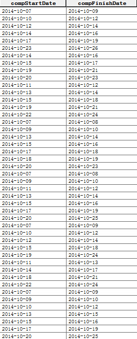

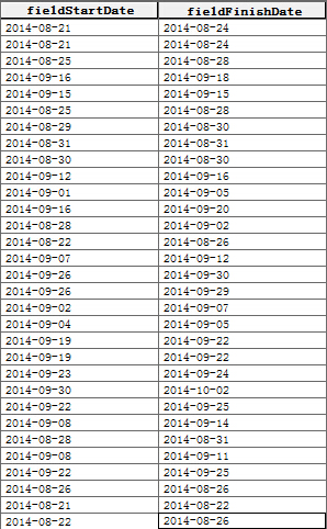

1.As picture below, the time logic should be fieldStartDate<fieldFinishDate<compStartDate<compFinishDate, all 4 fields are text not date type. I tried to change them into short integer, such as "2014-08-28" into "20140828", then subtracted one by one, if the result is negative, I know the date is wrong. But this is too complicated, is there any easy way to do it?

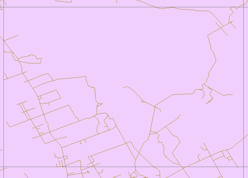

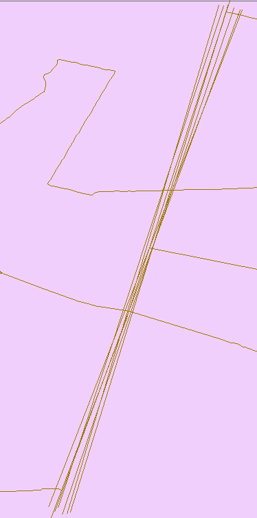

2.The original line feature was a total mess, instead of one single line there was dozens of line intertwined with each other and they break at intersections, I have to modify/merge/delete them one by one in order to make a single line, it took me a lot time, is there any easy way to do it too?

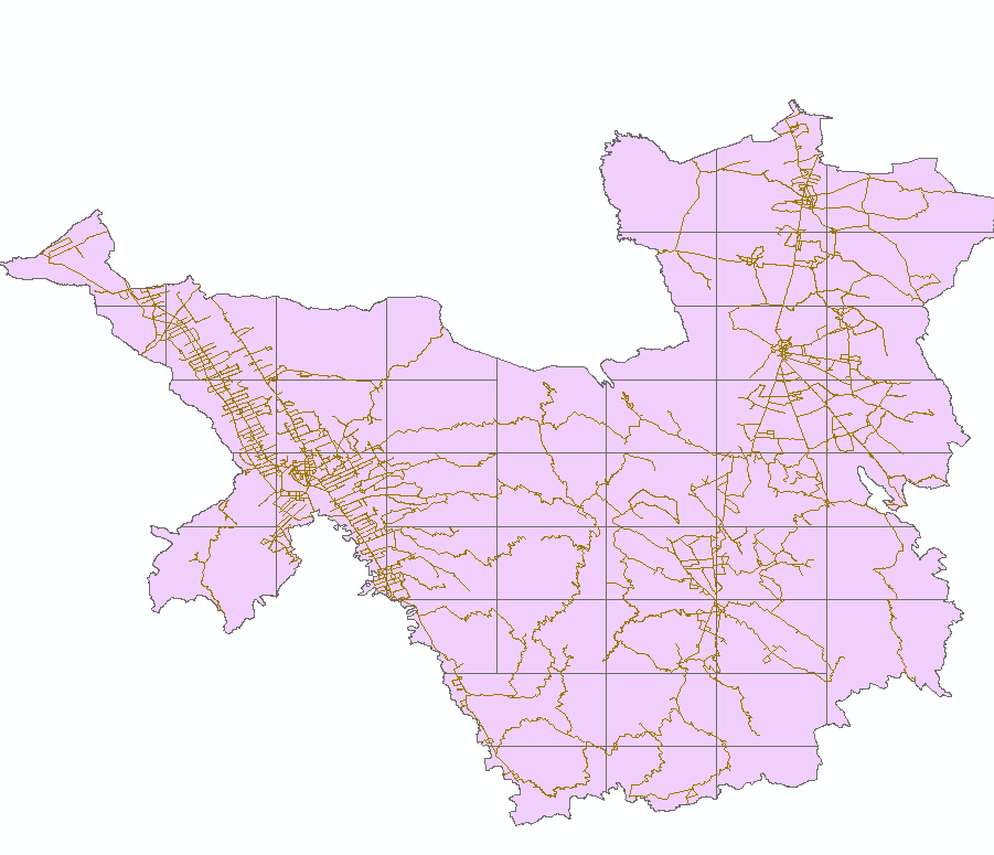

Yeah, this works only when I have one target area, but as you can see in the first picture, there are a lot polygon areas of lines, merge them manually would took me a lot time and I may miss some rows. And this is only one county, I've got the whole state.
