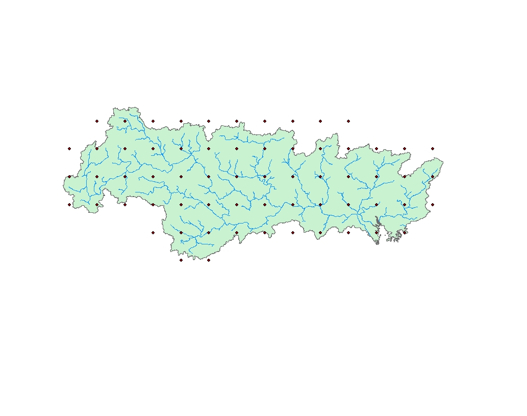

At the moment I have a data set table in .csv which contains 603 columns. Column 1 for latitudes column 2 for longitudes, and column 3 to column 603 are data for each grid point(shown as black dots in figure 1) in 600 months. So basically my dataset is in format like this:

There are 64 gird points and 600 months  in total and each point is separated by 0.5 degrees,
I did tried to search topics like importing xyz data to arcmap and followed the instructions to add data and display xy data, but all i got is map below. I also tried to follow the Arctoolbox, but I failed at the very beginning when I tried to convert the file(Arctoolbox>3D Analyst Tools>Conversion>From File>ASCII 3D to Feature Class/Point File Information)

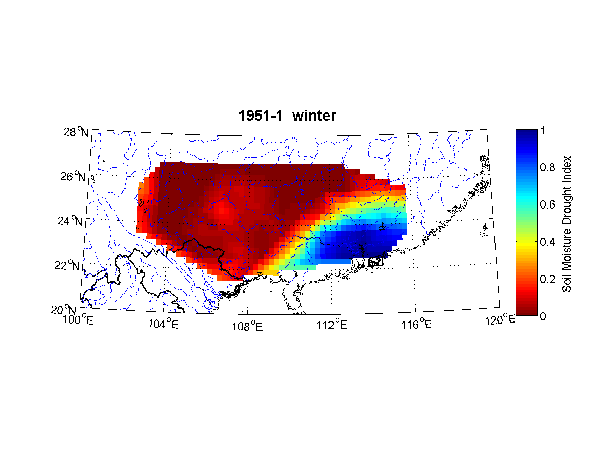

What I want in the end is plotting data on the map like I did in Matlab(shown in Figure 2) but in a shape more like a basin instead of mosaic one. And also in Matlab all the drawings(600 pics in this case) can be saved without doing it manually once the coding is right. Can I do this in Arcmap? I guess there is a more straightforward way to import this data and interpret it smoothly like meteorological application.

figure 1: grid points and research basin:
Figure 2: mapping using the column 3 data for same area in matlab(by interpolation to a finer resolution 0.25*0.25)1951-1.png
