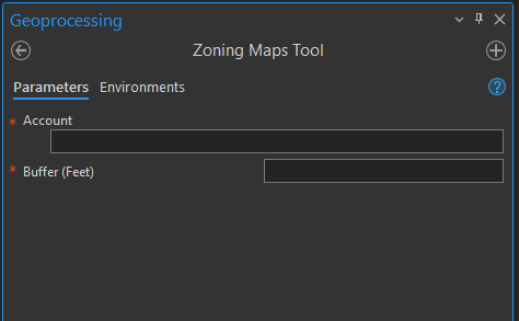

 Below is a picture of the input before I run the tool.
Is this the correct way to handle multiple input parcels? How should I set up the select tool to handle multiple parcels?

Seems alright to me. Remember a multi-value comes back as semi-colon separated, so first thing I tend to do split it into a list. You can add the following line to your execute function to get an idea of what is returned.
arcpy.AddMessage(account_numbers.split(";"))
