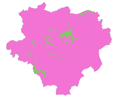

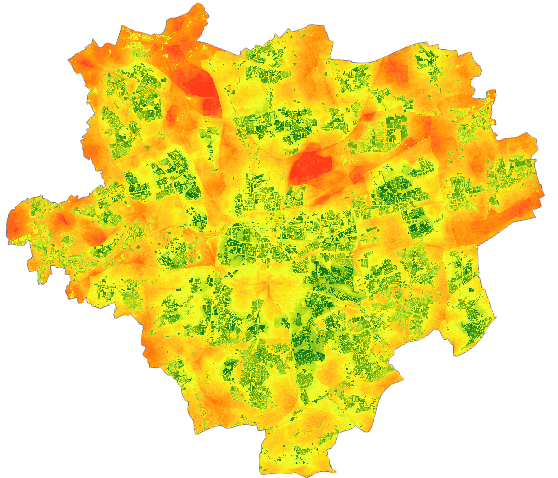

By calculating with P equal to 1 i get the results i want to:
with the value of

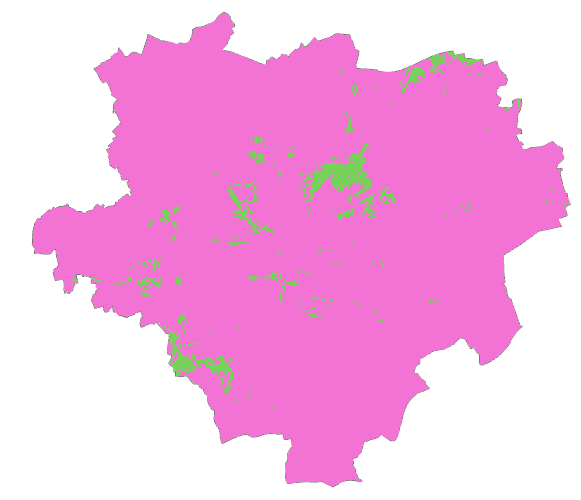

But if i try to use p as equal to 2 my results are disappointing.
With the value of
I have tried using the ^ symbole, aswell as square(), and multiplying the raster by itself but the results are still the same.
Does anybody know on how to use the square numbers reasonably?

DavidPike
MVP Notable Contributor
#Square
Power(inRaster, 2.0)
#Cube
Power(inRaster, 3.0)
#Square root
Power(inRaster, 0.5)

AlexanderSchuhmacher
Thank you! It worked!
