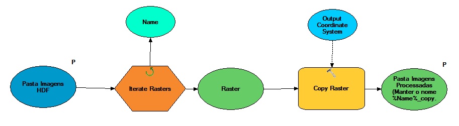

The first model that i built converts the entire folder to a geotiff image, with the same name but with a extension (%Name%_Copy.tif), it works fine if i need to convert just a few images, because i need to select just one date folder at a time, but i can't do it in the batch mode due the iterator for large numbers of dates, and this is very time consuming....

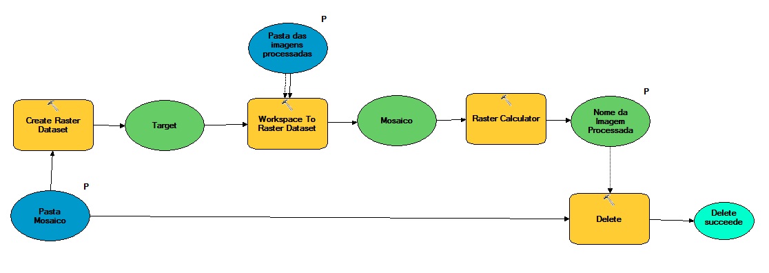

The second model transforms a entire folder into a single geotiff mosaic and rescale it, it works in batch mode, so this step is working just fine
If i join the models, when i execute it, the Create Raster Dataset process of the second model doesn't work anymore giving me the 9999 error.
So here's where i need your help, how can I execute the first model in a batch mode or there is another iterator that i can use to do this?
And the second problem but a optional one, why that Create raster process stops workin when i decide to join both models?

Victor I think you might be looking for collect value​ to collect all rasters you iterate through in a folder first. Try something like this
I also have a calculate value tool to remove any periods and remove ".hdf" for the output name, but if your tool works without using that then you don't have to worry about it. Also, you had the tool set up to delete the Mosaic Folder when the tool finished was that intentional? I set it up to delete the raster dataset after the raster calculator output instead of the whole folder.

Now the entire model works!
Thank you very much!
