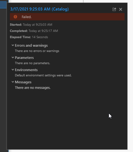

I created a model that runs fine when I tell it to.  I set it up to automatically run nightly via the scheduler feature in ArcPro.  It fails every time and doesn't provide any errors or info.

It will be very hard to say without seeing at least part of the script / model, but I think it's safe to say there's something in how you've written your script that isn't being handled properly in the standalone script.
What that might be can vary quite a bit. Please share your code if you can.
Barring that, I'd add some messages to your script so that you can get a better sense of where and perhaps why it's failing.
