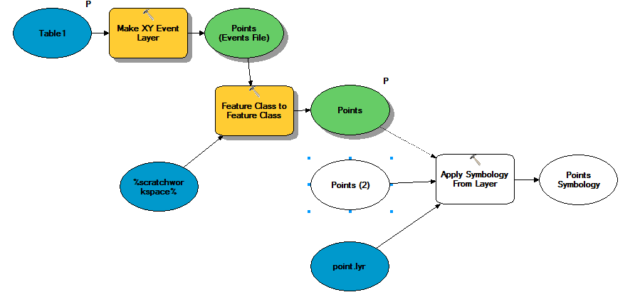

create an events layer, creates a feature class in a scratchGDB (default.gdb for the time being). then I want to apply the symbology and I am not sure the parameter are correct:
the problem is that this points feature it does not exits until I create it.
All the time I validate, the points FC disappears.
If i set my FC as a precondition how can I set a non existing layer as a input. I assume the problem is to be found in the scratchworkspace.
How can I make this working?

Did You try to make points feature (output) as layer
Add "Make Feature Layer" tool to "points" feature and before Apply symbology from Layer

This not only is the correct answer but also the logical one!
AdamZiegler1
Esri Contributor
Abdullah is correct. The Points layer created needs to be a feature layer to apply symbology. It looks like this (tested and works).
