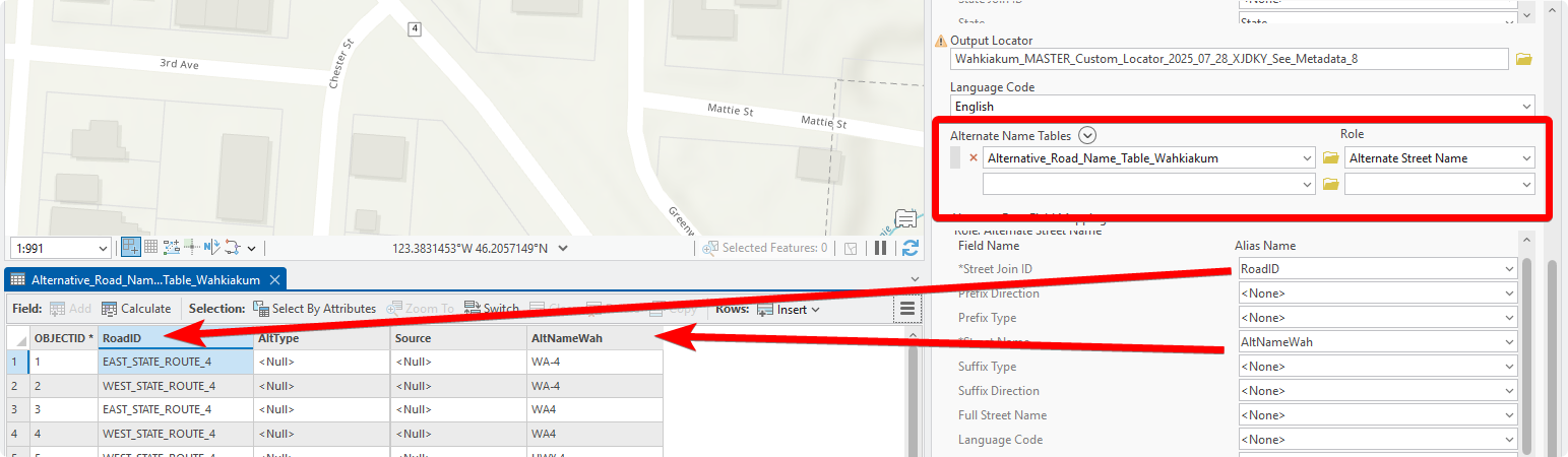

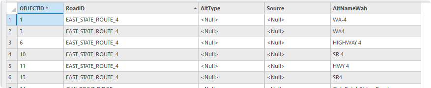

My Alternative Street Name Table has a field called "RoadID" (text) along with a "AltNameWah" field that contains the alternative name. For example,
WEST_STATE_ROUTE_4 may also be called SR4, WA-4, HWY 4, Highway 4, etc

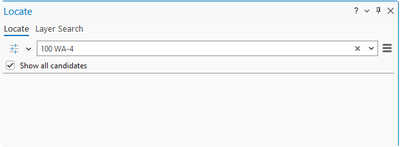

However, when I create the locator, the locater is not able to use the alternative names.
 (empty results search for 100 WA-4)
I receive the following warning when running the locate tool:
WARNING 003681: Only map 'StreetAddress.FEATURE_ID' when there are duplicate features in the primary data.
Locator build started
Data processing started
WARNING 002967: The alternate table 'Alternative_Road_Name_Table_Wahkiakum' cannot be applied to any of the primary feature classes. The locator will be built without this table.
those errors link here:
https://pro.arcgis.com/en/pro-app/latest/tool-reference/tool-errors-and-warnings/001001-010000/tool-...
But what are the "appropriate fields assigned to the primary feature class or classes." I cannot find where the appropriate fields are documented. Thanks.
WahkiakumGIS
The problem was I had mapped my RoadID field to the "Feature ID" field in the Street Address field mapping section instead of "Street Join ID." Duh! 🤦‍:male_sign:
