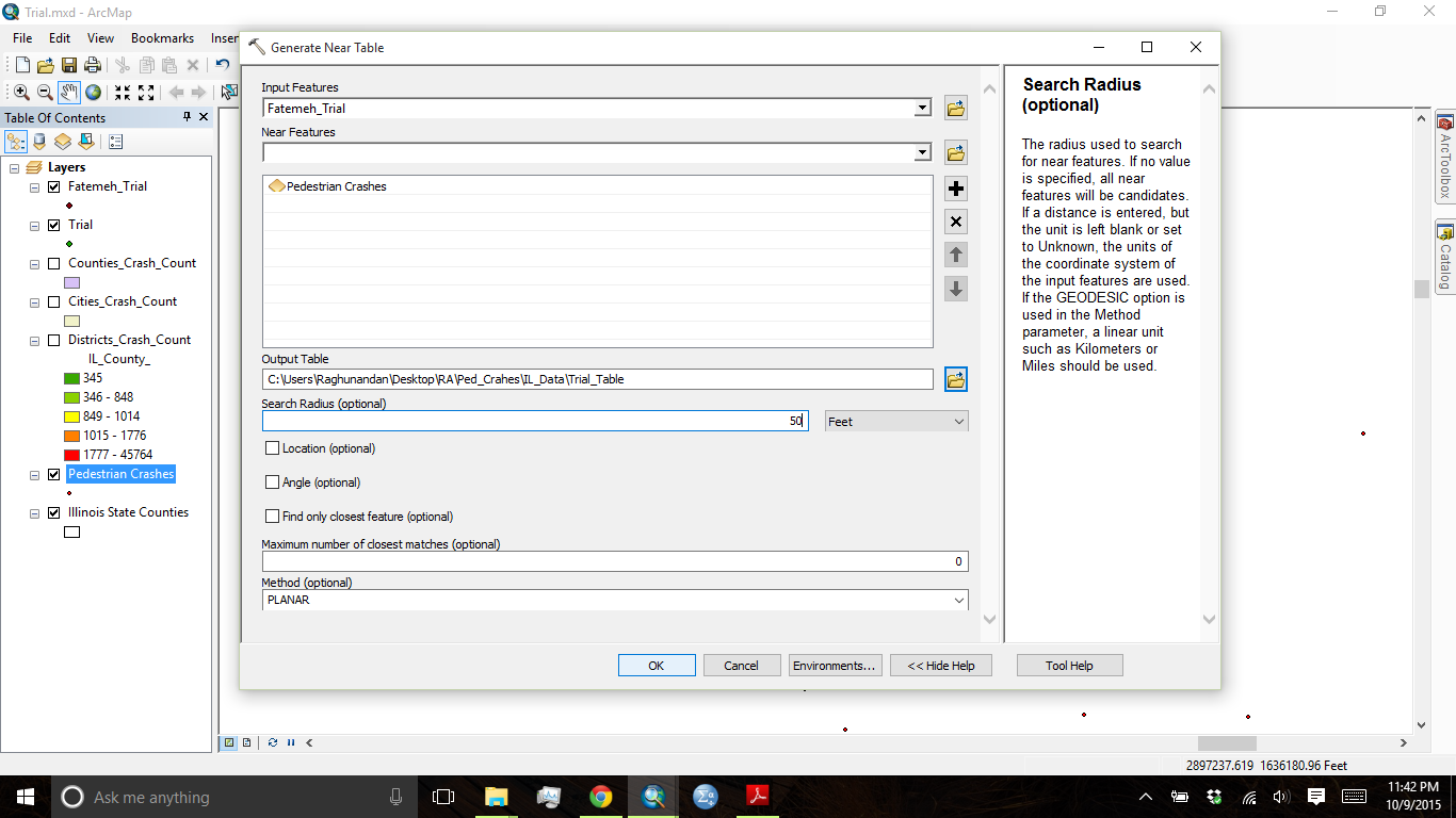

RaghunandanBaireddy1
Here is a screen-shot of the 'Generate Near Table' input dialogue box sir.Screenshot (13).png
DanPatterson_Retired
MVP Emeritus
  • try saving the file to a different folder  ie c:\temp\x.txt
  • make sure the file has a *.txt or *.dbf file extension
  • try the file against itself and if that works
  • try against the file you want repeating the above 2
