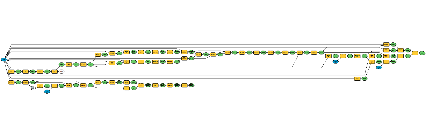

It seams that this discussion keeps going on without any solution. I've been having the same problem wit ArcGIS 10.3 and it would be really hard to use interactors given the size of my model. Any solution? Export Graphic.png

I found a quite simple solution for this problem. You just have to follow three steps when building you rmodel and it will work perfectly. 1.) You have to create a Geodatabase (don't use the default geodatabase from ArcGIS). I've created one in the same folder named "Scratch"; 2.) You need to set all of your output data as non-intermediaries, cause they need to be saved in order to run the model; 3.) Finally, when defining the output of each operation in model builder you have to use the sentence %i%. This is useful to say the mode that it should generate individual intermediate data to each Input of my batch list. For example, if I have a map algebra operator in my model, I should set the name of the output data as Raster_Decli%i%. As a result I would have Raster_Decli0, Raster_Decli1, Raster_Decli2 (...).
