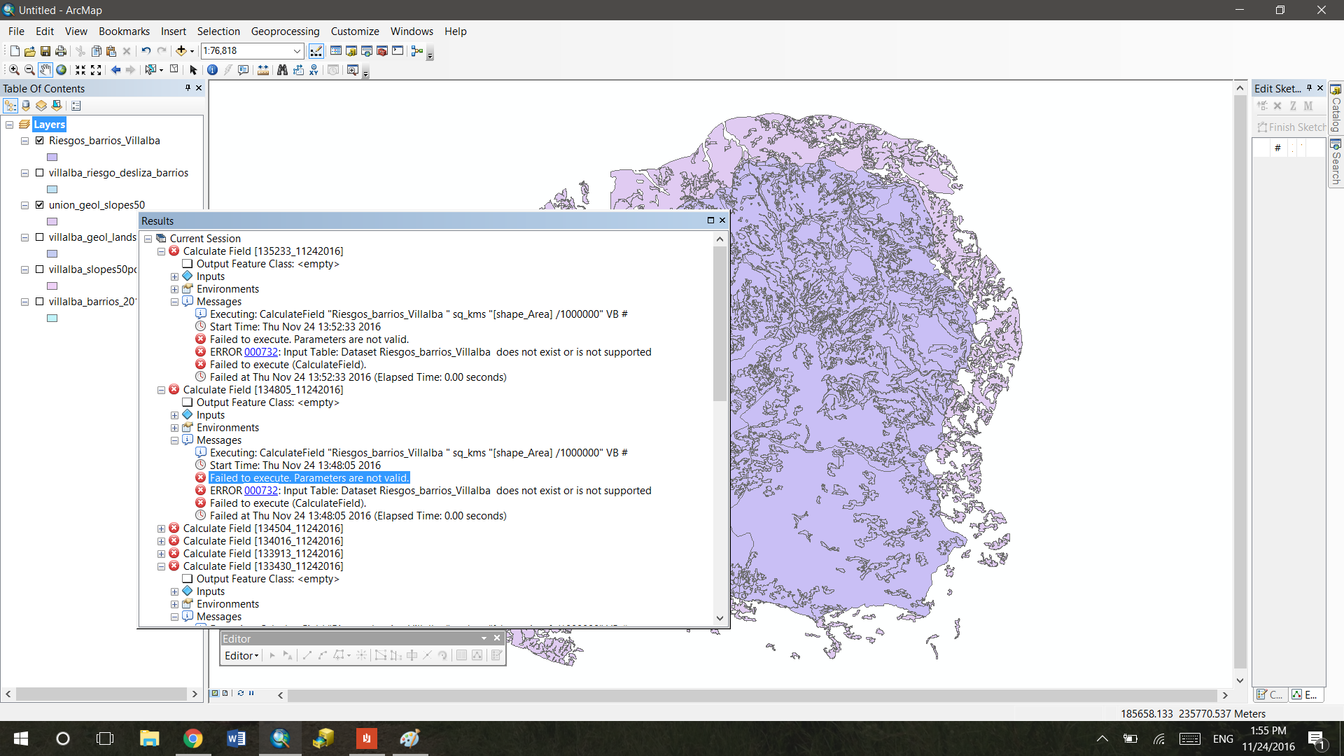

I'm trying to add a field in my attribute table to calculate square meters of some polygons using Area/1000000 but when I use the field calculator it says error in processing, check Geoprocessing Results window. So when I check this is the message:
What can I do to fix this? The fields are compatible, they're both type "Double" an decimal places the same. I checked the source of the dataset and it's the same as the rest. What could be the issue here?

I don't know why this would be the issue, but it looks like there is a space following the layer name. If there is one, try removing it. Also, have you tried restarting ArcMap since the problem started?

Ohhh my GOD. That was so stupid haha. THANK YOU!!!!!! The space after the layer name was the problem, I didn't even think of that.
