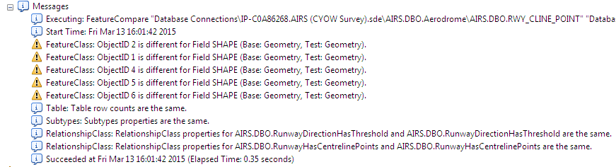

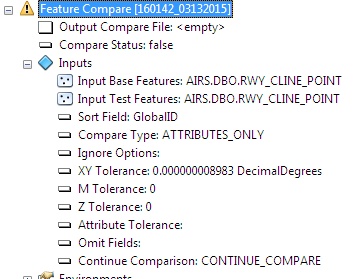

I'm trying to compare 2 different versions of a point feature class. I kept getting warnings indicating that the SHAPE was different, regardless of how large I set the XY and Z tolerances. So, I changed the compare type to ATTRIBUTES_ONLY, and I still get warnings indicating that the SHAPE field is different. Why is this happening?
Following are tool inputs and output messages:

I tried that, but it still doesn't seem to be producing the correct results. I changed the map projection to UTM, re-ran the tool, increased the tolerances to well larger than any differences that are present, still producing the same result. I also tried in ArcCatalog, with the same result.
I also notice that if I check the Continue Comparison result, the tool generates more warnings -- for different features. I was under the impression that this option would create multiple warnings for the same feature, if warranted, but perhaps I misunderstand that.
