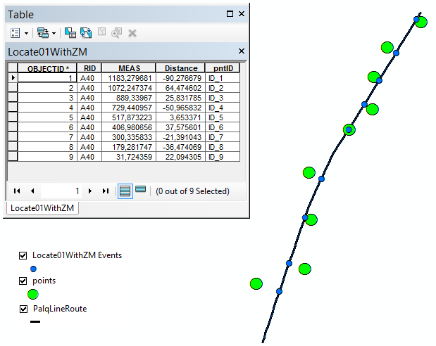

That's odd, if I create a route from the shapefile (in a fgdb), create some random points along the route and locate them, it creates the event table. It also lets me create a route event layer from the table:
I guess I will need some more information to find out what is going wrong. BTW I used ArcMap 10.2.2.
You said you disabled the Z values, but the polyline is ZM (Z=0 and M=NaN for all the points). What type of features do you have that you want to locate along the route?
