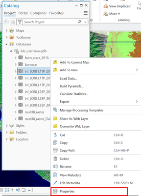

Hi, for classified raster parameter the raster should be in thematic source type. You can change the source type of the raster using the following steps:

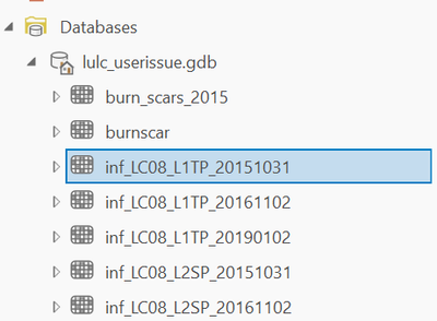

  • Open Catalog Pane.
  • Go to the location where you raster has been saved i.e. Database or Folder.
  • Select the raster and right click on it -> Click on Properties

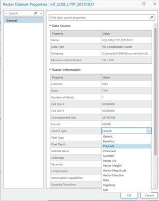

  • In the Properties tab, Go to Source Type -> Select Thematic from the drop-down -> Click Ok
