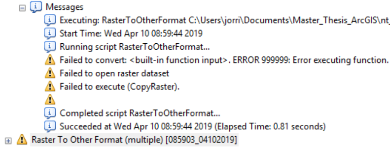

Following the steps of this link, I tried to convert a .bil file to TIFF format using the conversion tool 'Raster to Other Format'. The tool failed to create an output, see the error messages below.

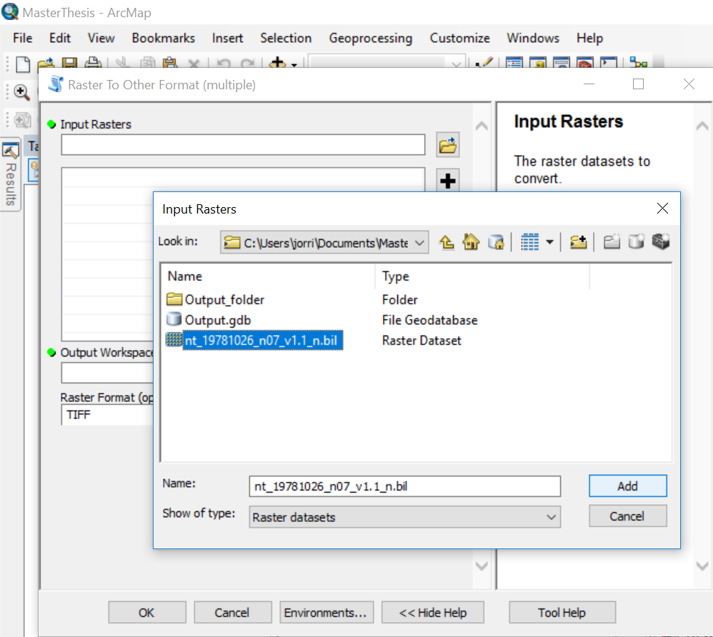

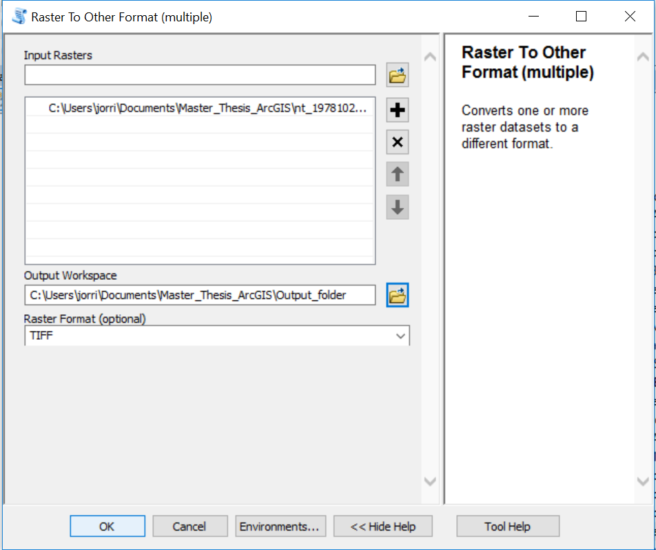

- I have tried different output formats (TIFF, IMAGE, GRID)

Image 1: Error message
Image 2 and 3: Raster to Other Format tool

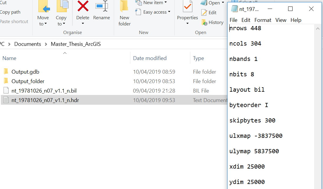

Image 4: .hdr file I created (see earlier link)

Did Copy raster fail to do the job? Use the folder as your output workspace and when specifying a filename, don't forget the *.tif to be sure

As for the hdr, try removing the blank lines

Unfortunately Copy Raster did not work. It returns the same error (see image below) as with the 'raster to other format'-tool. Removing the blank lines from the .hdr-file also made no difference.

Don't know at this point, but the filename has an extra ".", it might be worth renaming it and the header to "my.bil" and "my.hdr" since there seems to be some issues with reading the file from its filename in either of the tools (loading it and seeing it in Pro or arcmap is a separate environment)
