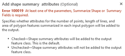

I seem to have stumbled upon something that I haven't seen addressed in any of my searches online but may help here. Because the "Summary Field" is basically the reason for using this tool, I reluctantly tried @KatMcDonald-Miranda's solution above, but it threw me a new error  (100019) for the "Add shape summary attributes" checkbox. Although this function is supposedly optional (https://pro.arcgis.com/en/pro-app/latest/tool-reference/analysis/summarize-within.htm), when I checked the box for it and re-added the summary field I had removed, the tool finally ran successfully. Again, the irony is that the documentation says both "Summary Field" and "Add shape summary attributes" are optional parameters, but Error 100019 says otherwise and requires that at least one of these "optional" options be utilized (see screenshot below). Going back to the original problem, it seems that Error 100014 has nothing to do with the real reason the tool fails (as we can see in this thread where the path and/or file name length workaround/solution did nothing to fix the problem), rather the "Add shape summary statistics" box must be checked for the tool to run successfully.
Not sure if this is a version issue, but I am running Pro 3.1.1 and never encountered this problem when using the "Summarize Within" tool in earlier versions of Pro.
