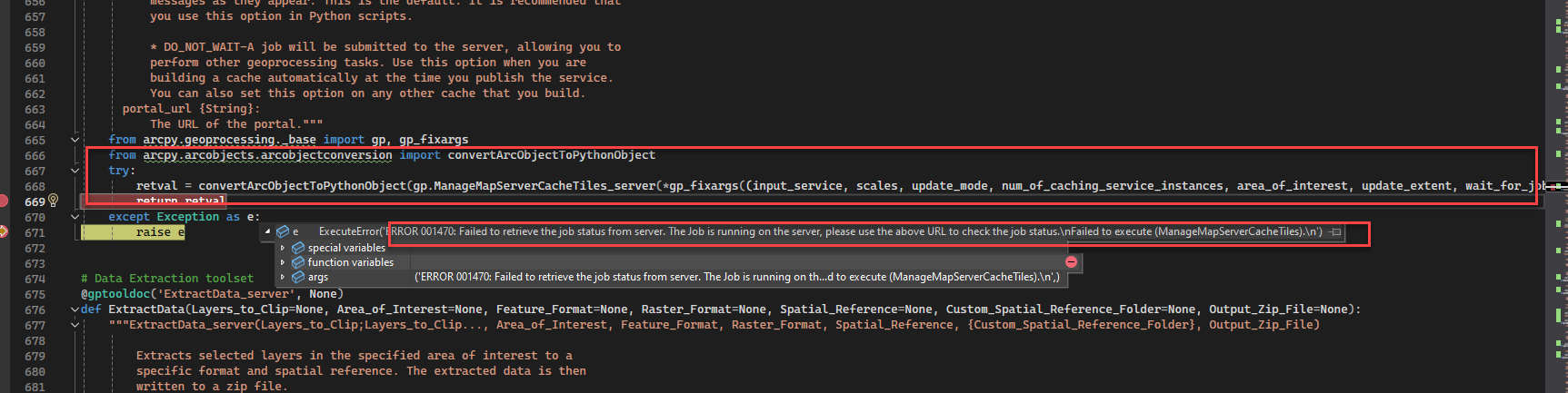

The job does finish on the server. During debugging, I noticed that my script eventually goes to this out of the box python code called "server.py" and invokes a method called "convertArcObjectToPythonObject ". I am using the "WAIT" parameter in the call for wait_for_job_completion, but still errors out and the error  does not have the job url either that it  recommends to use for checking job status.
