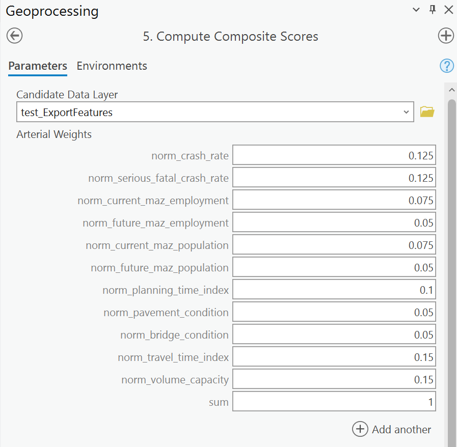

I'm creating a python toolbox and can't figure out how I can prevent the "Add Another"  button from appearing.  Below is the interface of my tool and the code that shows the property of the second parameter, Arterial Weights.  I figured setting the `multiValue=False` would do the trick, but it didn't work.  🤔
    param = arcpy.Parameter(
        displayName='{0} Weights'.format(mode_name.capitalize()),
        name='{0}_weights'.format(mode_name),
        datatype='GPValueTable',
        parameterType='Required',
        direction='Input',
        multiValue=False
 I

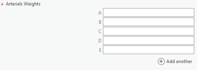

So, for example, with my own code, if I create a Value Table parameter with the default control, you get this (similar to your example):
        param1 = arcpy.Parameter(
            displayName='Arterials Weights',
            name='arterials_weights',
            direction='Input',
        param1.columns = [['GPString', 'A'], ['GPString', 'B'], ['GPString', 'C'], ['GPString', 'D'], ['GPString', 'E']]

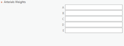

If I use the same parameter information, but then also set the controlCLSID value to a string of '{1A1CA7EC-A47A-4187-A15C-6EDBA4FE0CF7}', I get the following appearance, limiting the Value Table to single set of values.
            direction='Input',
        param1.controlCLSID = '{1A1CA7EC-A47A-4187-A15C-6EDBA4FE0CF7}'
