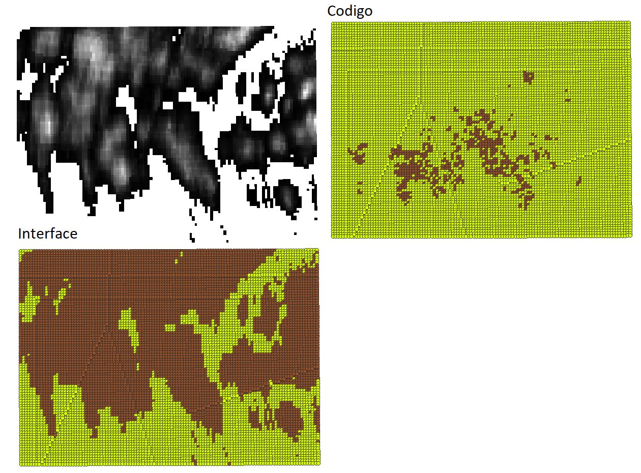

I've been trying to write  a script to extract values from some rasters (.tif) to a point shapefile. After sometime I noticed I'm not getting the same values I get when running the same tool from Arcgis Interface.

This is a sample of both outputs. Yellow points are values equal to -9999 empty points
Anyone has any idea how to solve this ?

Have you tried setting the environment setting, may be that's having a influence? Also try a different raster format.
