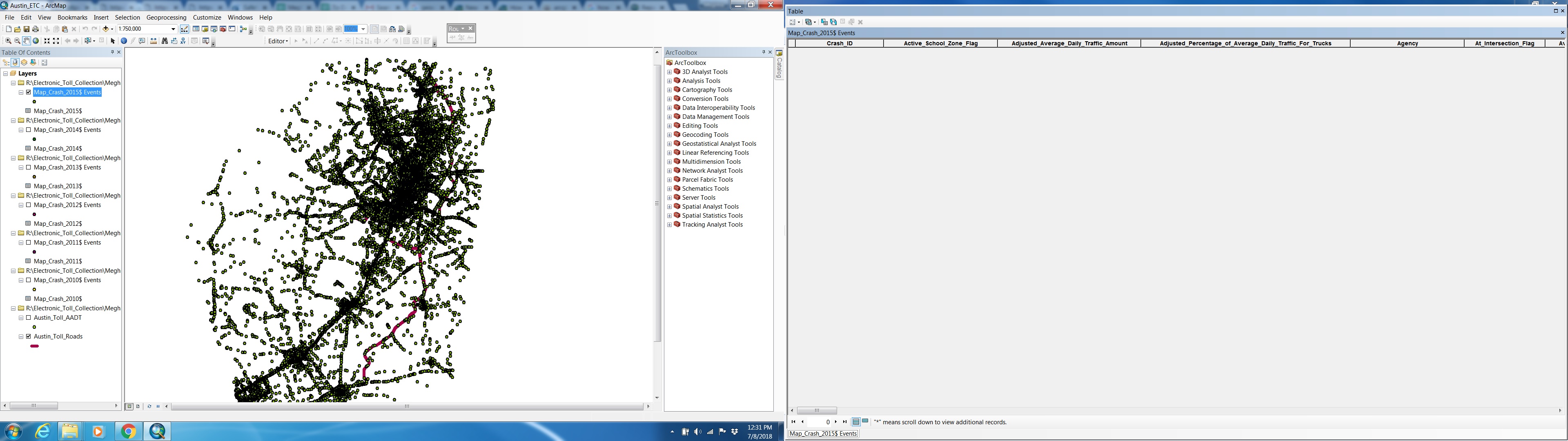

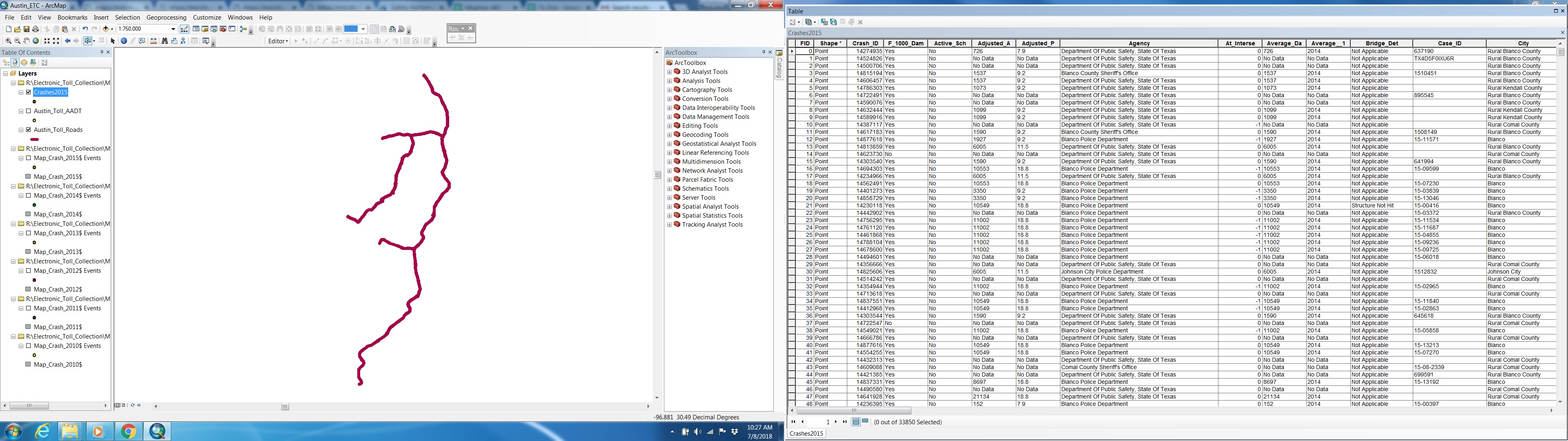

Your event points are overlaying some of the roads in the 2nd image.
Are you sure your roads (1st image) are complete?
Also... You should examine each layer in their own data frame without other data incase it is a matter of coordinate system differences.  ie. are your roads and your event data in decimal degrees?  An event layer should be converted to a featureclass/shapefile as soon as possible before making any further analysis

I absolutely agree with your last suggestion. And that was exactly what I was trying to do with the events layer. The events layer got created when i use "display X and Y" option. And the newly created events points show on the map but do not have any information in the attribute table. On the contrary, when I save the events layer to a shapefile it does not show anything on the map but has data in the attribute table. Attached the screenshots.

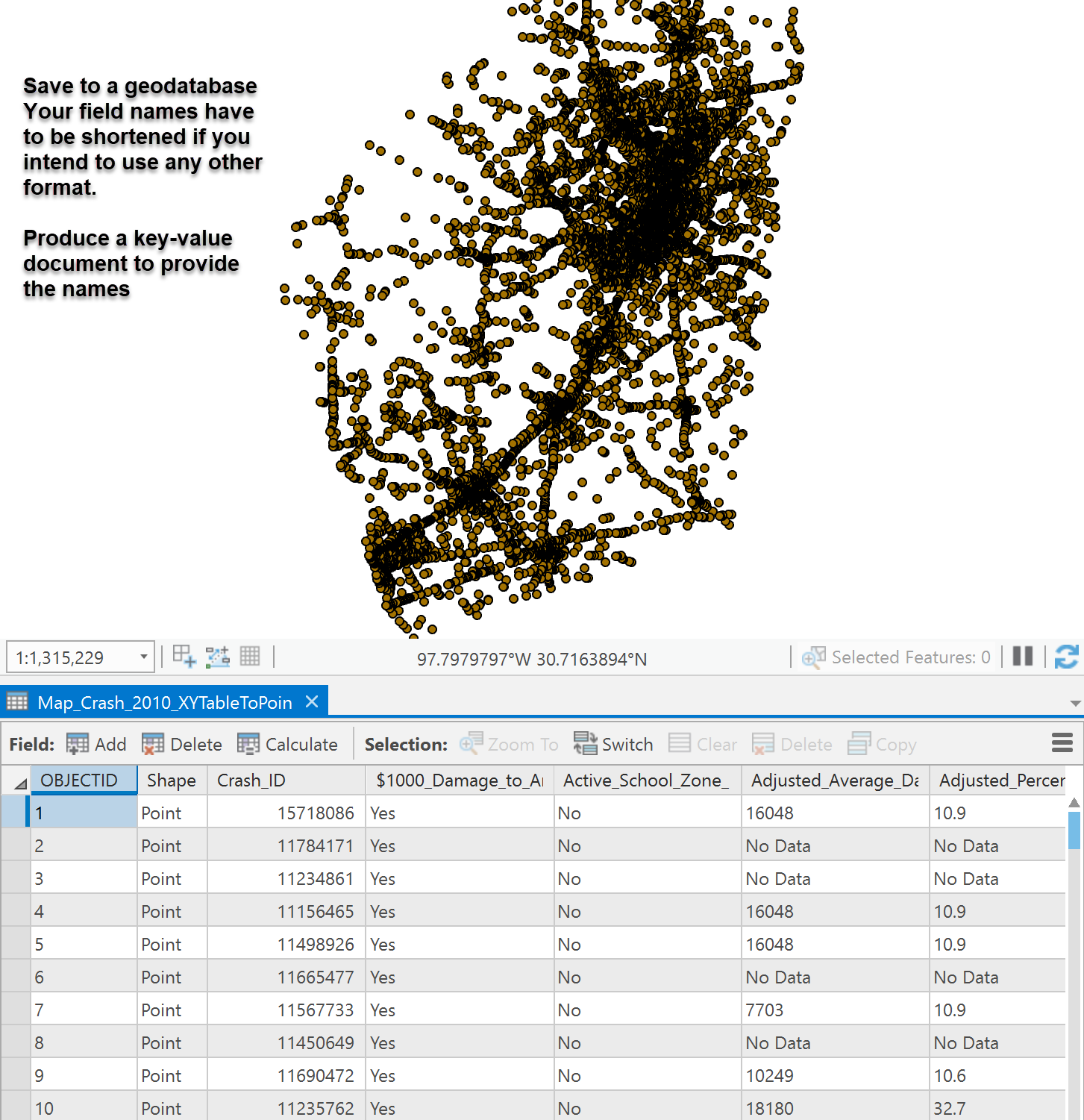

Xy to Point... save to a file geodatabase... everything is there... won't be a shapefile given the field names
