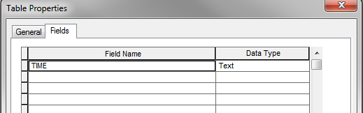

I have a CSV file with time date data in a field. Arc is disregarding the header for the field and setting it to TIME. Is this the expected behavior? I sure did not expect it....
I have deleted all but the offending fields out of the attached csv. If one looks at it in Excel or notepad++ the header is PINK_DOG; however, when I look at it in ArcCatalog the field is named TIME.
ArcCatalog 10.1
Excel
I want to import this into a FGDB and then append that into an SDE feature class. I would rather not have to deal with field mapping the time field to the proper SDE filed.

A big Plus One for testing your own problem... No one can fault you on using a wrong field name   As a finale to the test, I suspect that if you produced a replica field ... as text ... with Blue_Cat as the field name... the latter would pass through unaltered. I suspect, it is treating the field contents as being more important than the field name, in an effort to be helpful.
JayantaPoddar
MVP Alum
Strange! I am getting the Field_Name getting displayed correctly in ArcCatalog 10.3.1 (both CSV as well as GDB table).
