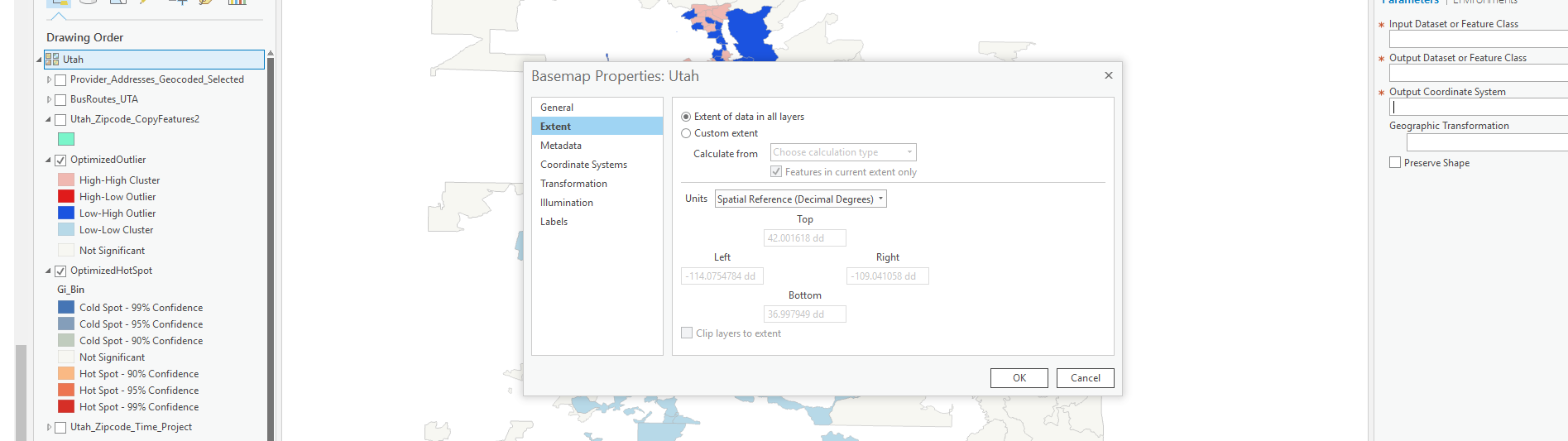

All four numbers are within the range of -180 to 180 and -90 to 90 decimal degree. See attached.
Thanks.
DanPatterson_Retired
MVP Emeritus
So they are NOT projected... use the Project tool
Project—Data Management toolbox | ArcGIS Desktop
you will know you have done the right thing since 'Project' makes a new file and you have to provide a the new name
