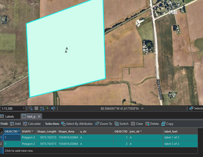

I think you're on the right track with your first approaches. Consider a very simple example: 1 polygon and 2 associated rows.
If I use Join Field on these two tables, the output is close to what you want. It appears and behaves a bit strangely because of the multiple values in the standalone table, which you can see in the attribute table and the polygon labels.
On the one hand, the polygon layer only has a single objectid, and it is impossible to select one without selecting the other. But on the other hand, the table and labels show two distinct features. Pro will give you a little warning when you've got a layer that's in this state.

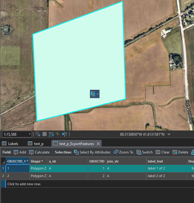

But the key here is that if you export the layer from this point, the output will be precisely what you are looking for.
I now have two distinct features in my output for each match in the initial join.
