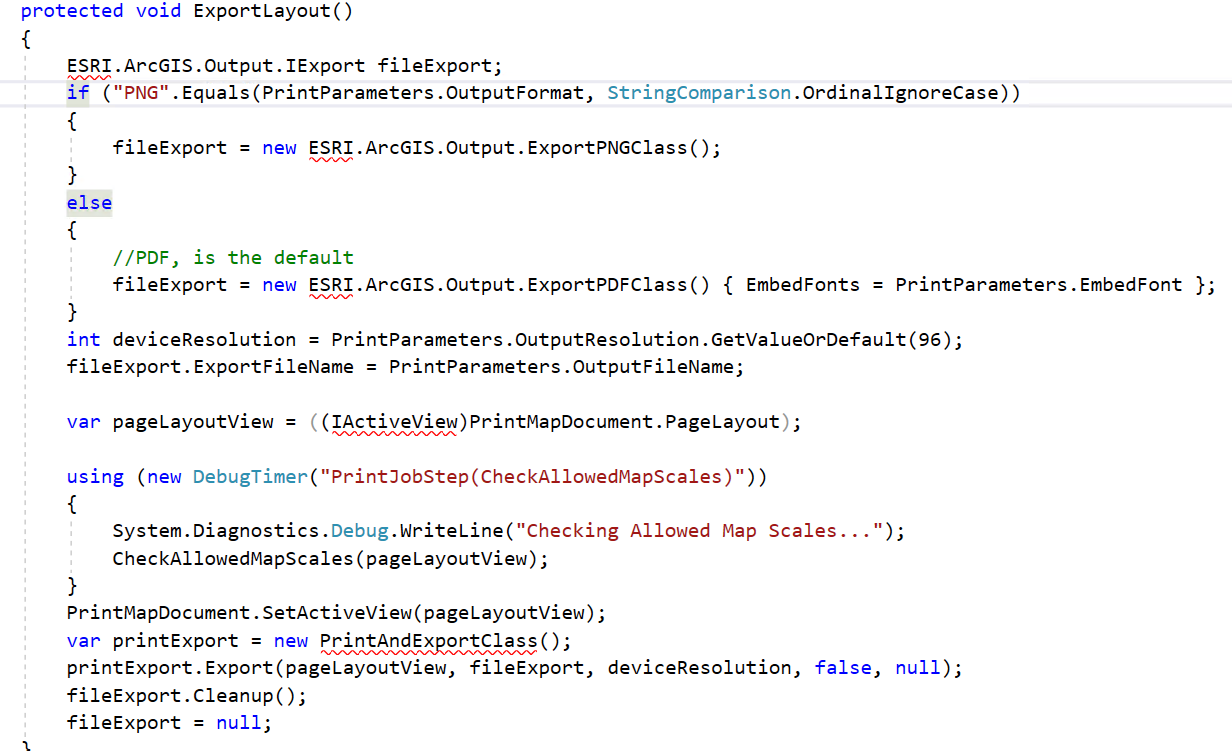

Hi, I have geoprocessing tool which opens a MXD template file to make PDF out of the map, using Export method.
Intermittently this tool throws error  COMException: Exception from HRESULT: 0x80040304
I am releasing COM objects but still sometimes throws this error. This is snapshot of my code:
Anyone has any ideas?

This error maps to one of the following:
 FDO_E_DATASET_CANNOT_RENAME "Cannot rename the dataset with objects already open."
 CADASTRAL_E_CONTAINS_COMPRESSEDDATA "No license available."
 WMSCONN_E_MISSING_URL "URL is missing."
 NETWORKLOADER_E_INVALID_FIELD_NAME "An invalid field name was specified."
 E_TEMPMETAFILE "Cannot create temporary metafile."
Hope this helps.
