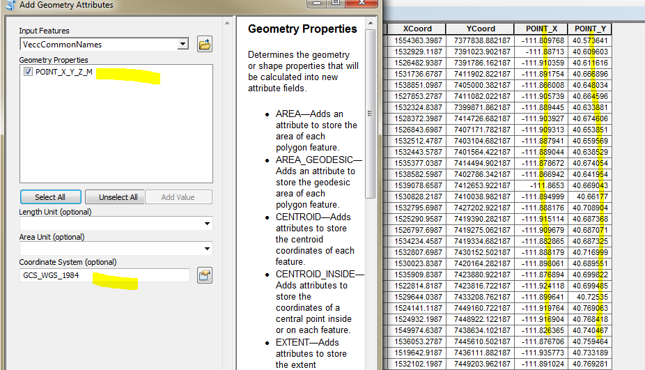

I just tried the Add Geometry Attributes tool on an existing set of points that already had X/Y coords in StatePlane Feet.  I selected only the Point_X_Y_Z_M property and gave it the GCS_WGS_1984 coordinate system, and it added two columns in DD.  See below:
That should just about do it....
MalcolmLittle
Yes, that did it! Tested it on 2 then batched the remaining 26. It even overwrote the original PointX & PointY fields made by Add XY Coordinates. Thanks, mate.
