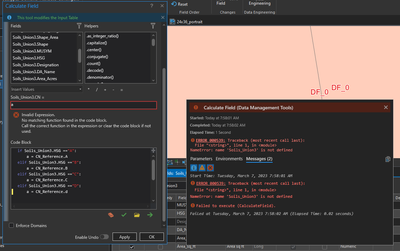

ChristianRowe
You helped get me closer but now I'm getting this error, any tips?
Thanks a ton.
by Anonymous User
Not applicable
calculate-field-examples - Check out the Calculate fields using logic section.
In the first block (expression) you need to call the function that you define in the Code Block.
SoilsUnion.CN =
calcfunction(!Soils.Union3_HSG!, !CN_Reference.A!, !CN_Reference.B!, !CN_Reference.C!, !CN_Reference.D!)
(you may need to remove the !.  Easiest way is to just double click on the field and Pro will put it in the argument with the right decoration.)
