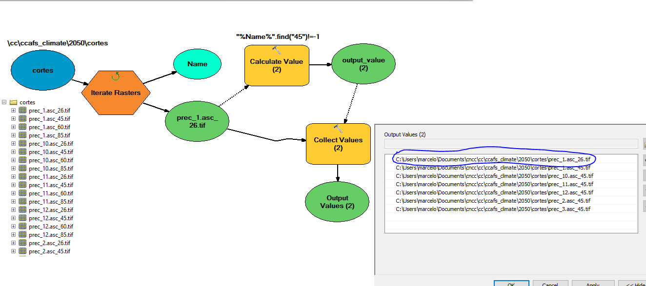

Hello,
I am using model builder to search rasters containing specific strings in the name within a folder.
What I want is to use the iterator in all raster in a folder, then run the "collect values" only if the precondition is true: "% Name%". find ("45") !=1
It works to some degree, always adds the first raster represented in the folder. In this case I look for the raster with the letters "45", the collect value ignores everything other than "45" except the first thing in this case "prec_1.asc_26.tif". (See the result of the collect value).
With the "recursive" option in the iterator, the output show as follows:
This creates a huge problem because I can not use other tools with that output. (Cell statistics "or others).
Note: I understand that I can use the wildcard, but this is a small example and I want to use several preconditions in the same model.
Can you please help me
Thank You Very Much

Even thought you show it correctly in the model builder label you say your Calculate Value tool is testing the expression:
Should it not be
"% Name%". find ("45") !=-1
I spoofed up the same model as you (although I was searching a folder of ASC files) and was able to replicate the same problem in ArcGIS 10.4.1. I too got an erroneous layer added in. I got rid of the Calculate Value tool and used a wild card in the iterator, this worked and only the files that fulfilled my search criteria where added to the collects Value list. So I think you would need to use the wild card approach as it looks like a bug in Modelbuilder. You could expose the wild card parameter as a parameter so you could change your search criteria if the model is run as a tool. As your model stands this is not a major change and makes it work...

I understand about using the wildcard but i wanted something like this:
Hope they fix it soon

Looking at your image you could try splitting this up into 3 sub-models, each sub-model using the appropriate wild card feeding into the collects value tool. Just an idea?
