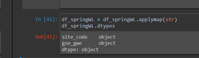

JulianaSpector1
Does the index need a field name? I'm not seeing the index show up as a column when running the dtypes argument.
