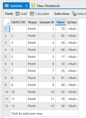

Here is an example table of my input layer, 12 rows with the values I want to put into quartile classes in the field Value and QClass is the field to record which class they are in, note the rows are all NULL as the code has yet to be run.:

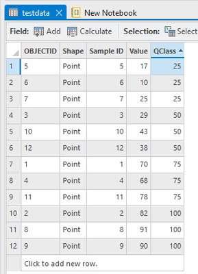

The results are shown, sorted by QClass:

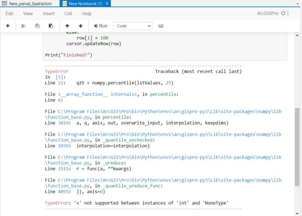

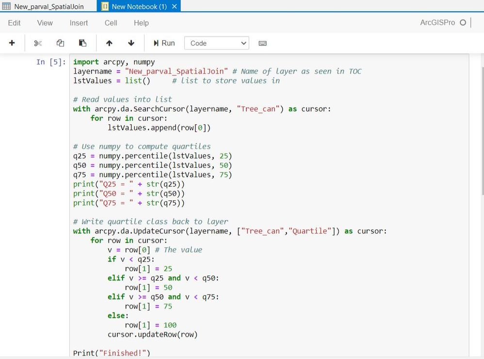

Thank you @DuncanHornby for the solution you posted above. I did run the code (plate 2) but it came back with an error (plate 3)
How can you help please?

OK, well done for showing your workings and its because you made the effort to show me I can make an educated guess! Your layername is "New_parval_SpatialJoin". The clue is in the name... I'm guessing you have done a spatial join with the new Add Spatial Join tool?  Well if you open your attribute table and move your cursor over the Tree_can field header, I'm going to guess its not Tree_can but something like "somelayer_spatial_Join.Tree_can"? Thats the fully qualified field name of the field because its a joined field. So what you see is what you need to use in your cursors.
EmekaUde
Hi @DuncanHornby, I figured it out. Actually, it was not because of the spatial join. The issue was that I had about three 'null' records in the Tree_can field. After populating the null cells with zeros, I was able to execute the code successfully to obtain the expected results.
