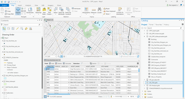

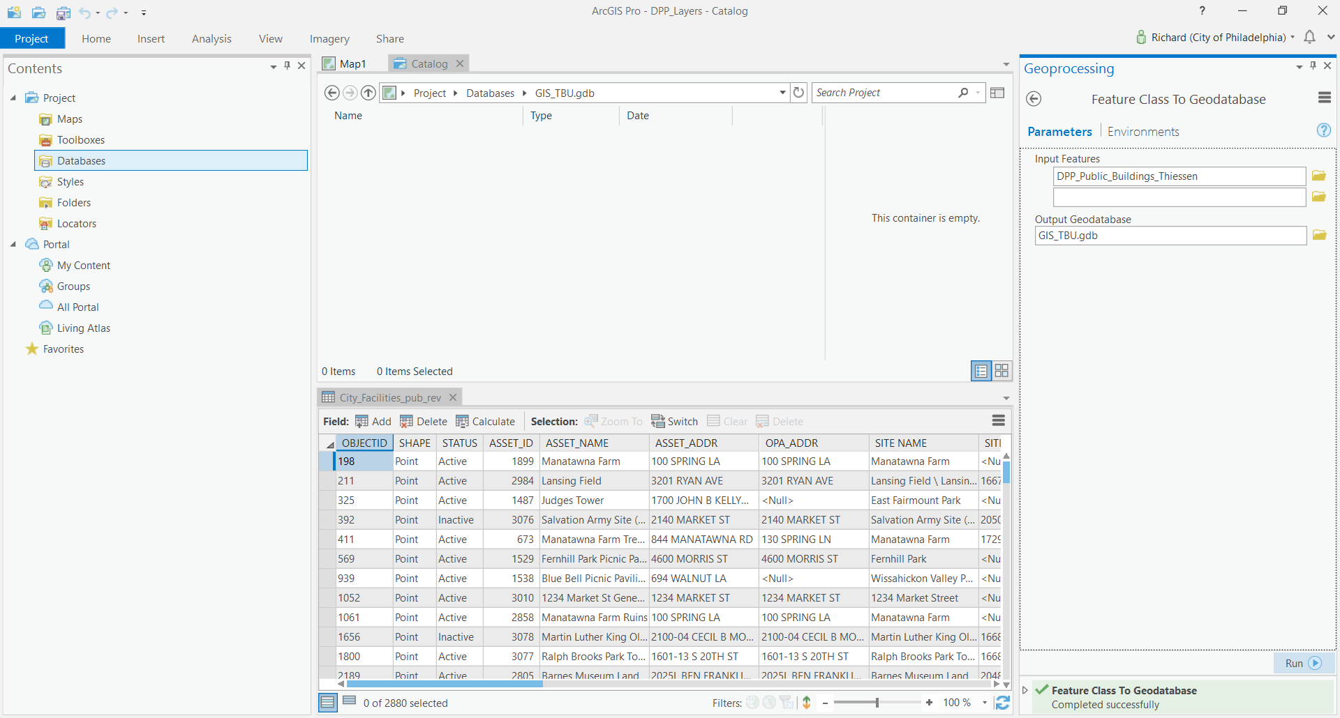

During:
After:
Note at bottom the new Geodb: GIS_TBU.gdb created in ArcGIS Pro did not receive any of the feature classes despite the process above it saying it had been successfully run.

To follow your scenario exactly, I used a feature class I had made in Pro, a Thiessen Polygon class, and exported it from my analysis geodb to the new Pro Db I had made - called GIS_TBU..gdb - again the process worked according to the message at bottom right, but again, as evidenced by the Catalog window at top center, no feature class actually was exported.
