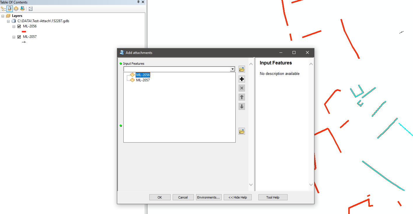

Input field looks like this and I don't see how I should select features...
How the tool input looks like

It seems that I misunderstood what "interactive input" means according to the help from Canada in the mentioned thread on gis.stackexchange.com.
So the question is a simple one now: Is it possible to create a GP tool with input that accepts selected features in ArcMap? (I will create a new question for this)
