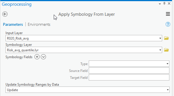

Think I've found a bug
To my understanding this arguement should recalculate my quantiles based on the new data, but it just uses the same classes from the source Symbology Layer.
Here are my inputs:
Once I've run the tool as per above, here are results:
Note, exactly the same break points... not what it is supposed to do... which is"
Anyone got ideas? Thanks.

I apologize that you're experiencing this issue.
I tested this workflow and to me it appears to be a bug that the ranges don't update.  I've logged [BUG-000115732: Update Symbology Ranges by Data does not have any effect when using Apply Symbology From Layer with raster data.]  If you're experiencing this issue, please call technical support to verify and get attached to the bug for tracking purposes.
Thank you.
